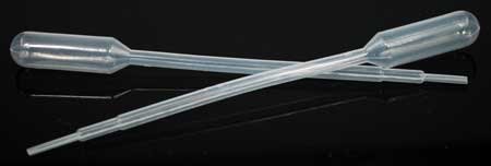

For cleaning PCBs and connectors, I use 99% purity IPA, something like this
https://www.amazon.com/Isopropyl-Al...F8&qid=1540632006&sr=8-3&keywords=isopropanol
A gallon would last a radio repair hobbyist a lifetime as you only need a Q tip full to do 3 or 4 connectors.
Magic on scratchy switches if a drop is placed carefully inside using a 1 ml pipette.
One caveat, you must keep this away from kids or pets, no ifs no buts, extremely dangerous if even very small amounts are ingested.
