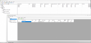

Thanks for the replies so far! I have done a bit of reading and watched a few videos at this point. I think a have a pretty good handle on adding sites in Sentinel from the database. What I'm having issues with is the manual add that I will need to do to enter all the team radios for next weekend in Austin at the COTA WEC race. I think I've wrapped my head around using the Site | Department | Channel system, but I'm just not sure how to enter the channels and set this favorite list up for successful scans once I'm trackside. I obviously can't test it beforehand :)
I'll attach a screenshot of what I have so far.

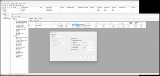

So a bit of research and I think I'm making progress.
The list doesn't have any TGID listed. So I assume this is a "NXDN conventional" rather than trunked system?
When adding a conventional system I do get the option to add the frequencies.
Does this seem correct to you experts?

By the looks of it, this is a mobile/repeater system, much like ham radio, so I'd say conventional NXDN, not trunked.

@Ensnared I couldn't find any way to import the WEC page, so I've added it manually. I'm aware that I won't be able to pick up the TETRA teams at the race, I'm hopeful I can still get the others on NXDN. I'm still not sure if I have the favorites setup properly tho. As @dmfalk mentions I think I need to set the system up as conventional (anyone else confirm?).
I've set up each car as a "department" and added the car repeater and pit frequency plus the RAN number. I read somewhere I don't need the "car mobile" frequency, but if one of ya'll could confirm that would be great.
Screenshot attached of how I added the teams; would be grateful if someone could check my work. (they are all setup the same as this)
If they are using a repeater, you just need the repeater output frequency. You don't need the mobile frequency (Repeater input frequency). You will hear everything on the output.
