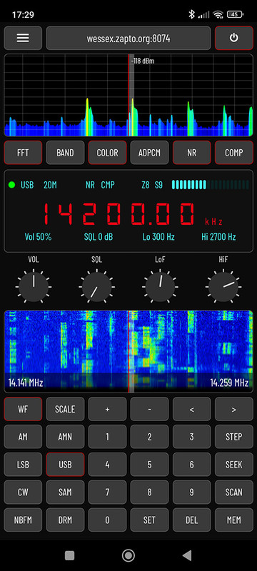

I’ve been programming a mobile client for the KiwiSDR protocol, and I finally have something worth sharing: QiwiQ.
It’s a dark-theme, portrait-mode KiwiSDR app for Android.
Instead of running in the browser, my app processes the KiwiSDR stream locally on your phone.
With no official KiwiSDR protocol documentation available, I relied on example Python code and reverse-engineered browser clients to piece together how the protocol operates.
Features:
• Connects to the public shared KiwiSDR network of servers.
• Built-in waterfall FFT display with zoom and pan.
• Direct band buttons for fast hopping between ham/shortwave bands.
• Frequency logging and memory list.
• Audio options: noise reduction, compressor, ADPCM compression.
• Gestures for tuning: swipe digits up/down, swipe waterfall left/right.
• Knobs for volume, squelch and bandwidth filters.
• Theme colors for the LCD display.
It’s still early days, but it’s working pretty well, I guess ;-).
Download my QiwiQ.apk at: https://vanbarel.eu.org/tools/qiwiq/
Side-load on Android, feedback/bugs very welcome!

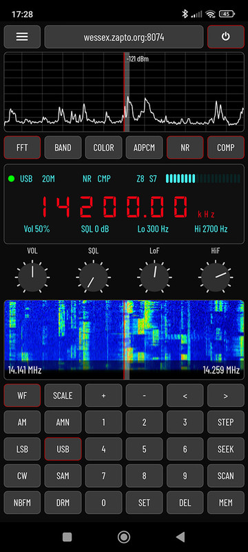

New version of QiwiQ released: 1.44
• FFT Spectrum Display with adjustable smoothing (averaging adjustable in settings)
• Squelch implementation for NBFM
• Waterfall color improvements
• Bug fixes + ui-improvements
Download at: https://bit.ly/3I49LfD
Feedback/bugs welcome!

New version of QiwiQ released: 2.02
• New interface with both Waterfall and FFT Spectrum on the display
• Selection between Color and B/W FFT graph
• FFT spectrum has a scaling grid and a dBm measurement
• Band buttons are available via a dropdown selector
• Dedicated buttons for Station SEEK and Station STEP mode
I have listened to the users feedback and reused the space occupied by the band buttons to show both Waterfall and FFT Spectrum on the screen. The FFT and Waterfall can be switched off to reduce bandwidth and processing power.
The Band buttons are available via a drop-down selector.
The automatic station detection using the AOKI Shortwave Frequency Database now has a dedicated SEEK button.
There is a new STEP mode button, to cycle through the preset memories using < and >.

New version of QiwiQ released: 2.05.20
• New FFT Auto maxdBm adjustment: auto-adjusts the maxdBm value to the maximum signals received (always active)
• New FFT Auto Noise-Floor mode: auto-adjusts the noise-floor value (switch on/off and set offset in settings)
• BASE button replaces SCALE button: drag up/down to shift the base noise floor (when FFT Auto Noise-Floor is off)
• FFT Auto Noise-Floor mode can be temporarily disabled from AUTO to BASE mode (manual adjust)
• Both AUTO and BASE buttons can be dragged to change the noise-floor offset
• mindBm and maxdBm labels (bottom/top values) added to the FFT display
• FFT Grid-lines at 10dBm multiples
• Signal-meter bug fix and + sign for values over S9 (Sx for x <= 9, S+x for x>9)
• Frequency clamping removed for servers > 30 MHz (Fix)
• SEEK now rounds the current frequency to the nearest kHz to make seeking stations in the database easier
• Kiwiservers database auto-updated every 20 minutes in github
• Stations database auto-updated dayly in github
• Faster startup using custom kiwiservers- and stationdatabase in github

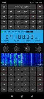

grahampaull
May 31, 2013
122
This is a phenomenal little app, works great in my S24 Ultra.
Suggestion would be for a Tablet View which allows greater use of the real estate on larger screens when in landscape mode.
XPL0RR
Sep 3, 2025
13
Could consider that, but then the buttons get very unnaturally looking enlarged. Do you think this is acceptable?CropperCapture[317].jpg
grahampaull
May 31, 2013
122
Maybe have a larger spectrum view in tablet/landscape mode? and also bring in the presets to the front end?
I know a quick Photoshop is easy to do compared to refactoring Android Layouts, but this is just as a suggestion. You could bring some stuff onto the front end like memories and even some of the settings, that way buttons wouldn't need to be stretched too much.
All just food for thought. :)
grahampaull
May 31, 2013
122
Could consider that, but then the buttons get very unnaturally looking enlarged. Do you think this is acceptable?View attachment 191667
Didn't see this when I posted my mockup. I think brining in Presets to the front end could be handy and would allow the buttons to be tightened up. Although, the mockup you have done actually doesn't look too damn bad and is more than acceptable.
