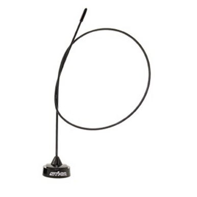

I'm in SAR and bought a NX-1700 kenwood. It came with a rather riged 1/4 wave which fits in the garage, but I need something more flexible before the wife realizes what that horrid scraping sound is on the garage door. Need to be 1/4 wave (for height). Normally TX/RX 152MHZ+ but we do some ham stuff (I have a tech license) when out in the boonies. Suggestions? Currently have a NMO mount

I have some Sti-Co flexi whips (Nitinol) and they are more flexible that other whips. They are covered with a layer of heatshrink that could get torn up if the garage entry has a sharp edge or if it scrapes along stucco, concrete, etc. They are expensive new but show up on eBay for good prices now and then. I think the most I paid for one new in package was about $30.
