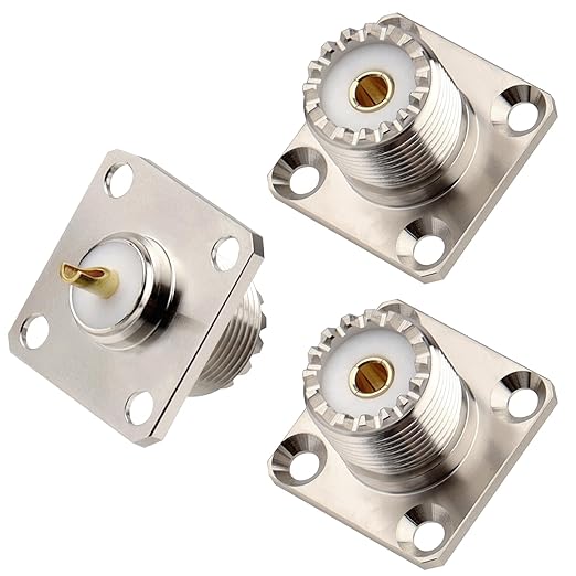

Last question: I think this the bundle I need to build a ground plane antenna and hook it to my SRD. What do you think?
3 Pcs UHF Female Jack SO-239 Bulkhead Panel Chassis 4-Hole Panel Mount Solder Connector
Ham Radio Coax Cable 50 Ohm, RG58 Coaxial Cable 50FT,
PL259 Male to Male Coax + UHF SO239 Female to SMA/UHF/BNC Adapter 4-Pack
2 Pack 12 Inch UHF SO239 Female PL259 to SMA Male Plug Crimp Adapter RG316 Cable Jumper Pigtail 30cm

Wouldn't mind making one of those myself. There's only 2 radials for the ground plane though? Thought there was 4? Guessing you mount them in the center instead of using the pre-drilled holes on the base like below?
Or are there supposed to be 4 ground radials mounted at those holes?

I never noticed that. I will try it with 4. Ordered the connectors today. Same as your picture.
Minimum 3, I'd do 4. Don't go by the drawing, they are just showing a broadside view.
Use the predrilled holes and something like #6 hardware. You might be able to solder them, but you've got to have a really hot/big soldering iron and the skills to use it and not melt the insulator.

Thanks, they seem easy enough to make. Be an interesting project. I think it would be easier to bolt the radials instead of soldering for sure. I have an old soldering gun but I think that would be too hot and overkill. Would definitely melt the insulator with that beast lol.
