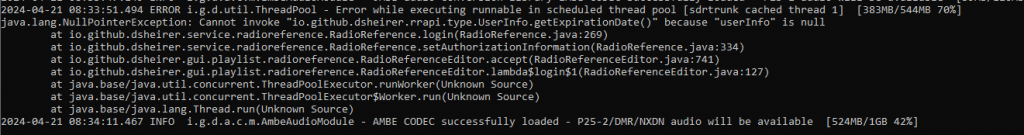

I've recently installed SDRTrunk on an Ubuntu system without issue. I've signed up for a premium Radio Reference subscription, but after entering my username and password into the Radio Reference tab on the SDRTrunk playlist and hitting ok (or Test Connection), I receive a java error: Cannot invoke "io.github.dsheirer.rrapi.type.UserInfo.getExpirationDate()" because "userInfo" is null.
This seems to imply that either something is not being passed to the login page, or received back from it.
I've had no issue pinging radioreference.com, logging into my Radio Reference account via the web, or any other usage of SDRTrunk. Any suggestions on what might be wrong? Thanks for the help...

Your not alone. I get it in 060 final and 061 beta 1 on Windows 10. My username is there but password is not and always was.
Since its happening on a few past builds I have that all worked fine it may be something on Radio References side.
@DSheirer
20240421 083507.809 [sdrtrunk cached thread 1] ERROR i.g.dsheirer.util.ThreadPool - Error while executing runnable in scheduled thread pool [sdrtrunk cached thread 1] [576MB/684MB 84%]
java.lang.NullPointerException: Cannot invoke "io.github.dsheirer.rrapi.type.UserInfo.getExpirationDate()" because "userInfo" is null
at io.github.dsheirer.service.radioreference.RadioReference.login(RadioReference.java:269)
at io.github.dsheirer.service.radioreference.RadioReference.setAuthorizationInformation(RadioReference.java:334)
at io.github.dsheirer.gui.playlist.radioreference.RadioReferenceEditor.accept(RadioReferenceEditor.java:741)
at io.github.dsheirer.gui.playlist.radioreference.RadioReferenceEditor.lambda$login$1(RadioReferenceEditor.java:127)
at java.base/java.util.concurrent.ThreadPoolExecutor.runWorker(Unknown Source)
at java.base/java.util.concurrent.ThreadPoolExecutor$Worker.run(Unknown Source)
at java.base/java.lang.Thread.run(Unknown Source)

Having the same problem. Worked fine yesterday morning but i did a full uninstall of sdrtrunk and when i went to do a fresh install i get the same message logging in
