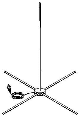

You can if that's what it was designed for. Pretty sure this is his antenna:
Well I'll be a son of gun!!! He said he bought a iba5 and I looked it up but didn't see it it on line so just thought it was a regular antenna... What will they think of next!
That's what I think the OP is referring to as well. I found it on Firestik's website and it notes that RG58 is used. I suspect the OP mentioned RG6 accidently as he may have been more familiar with it and got that stuck in his mind. Can't say that's never happened to me. He hasn't been back in a week so hopefully he'll pop back in a clarify things.

I don't think a vehicle antenna will work for a base station.... it needs metal under it for a ground plane.... I fooled around with Firestick Antenna's many years ago.... they always show a decent SWR... very easy to tune.... but they don't actually seem to work!
BEST advise I can give you is to get rid of the firestick
Thank you and yes, I know the FS was a compromise going in. As clarified, it is an antenna for indoor use where no exterior is allowed, not an auto antenna. The manual claims it utilizes a concrete slab as the ground plane <shrug> I'm dipping my toes in and may just put it in the truck, see original post. I'm just trying to get signals, it may be completely dead in my area and not worth an exterior antenna.
The printing on the cable is compressed and it looked like 56, but just checked it's RG-58. Hence the question mark, I have a severe case of CRS. :ROFLMAO:
