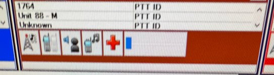

I have a tone coming across a single talkgroup at 10-second intervals on a trunked system. The radios on this talkgroup are not displaying any messages, and dispatch is not seeing any particular radio broadcasting any alarms. This happened about two months ago and only lasted for a day. Now that it has started again, it has been continuous for about two weeks straight, and I am at the end of my rope. I was dropped into this role with no training outside of using CPS, so I am still learning. Any help would be greatly appreciated.

Do you have a wireline console? If so check to see if "Channel Marker" is activated.

If is the marker tone, you'll be looking for the icon that is displayed on the far left here. A tower with a red dot at the top and a music note next to it.

Go to your communications dispatch center, turn off channel marker and then remove the button from the screen. Unless it is actually used, it's just simply not necessary to have on the screen for this exact reason.
After that, find the idiot who left it on the screen during staging and kick 'em where the sun don't shine.
