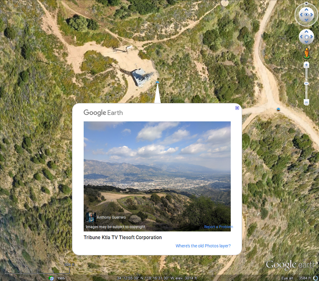

I spent some time digging. The WPSG400 license indicates that 166.25 lives at 250 Mesa Lila Road in Glendale. Google Earth shows that to be the address of the mouth of a very long dirt road leading away from a residential neighborhood into the Verdugo mountains. It eventually swings around and connects up to a radio site east of Verdugo Peak itself, whose written site description in this Glendale city document matches what I see visually in Google Earth. One of the Panoramio images at that location is labeled "Tribune Ktla TV Tlesoft Corporation" (also here).
Just a guess: KTLA has something up there, 166.25 is co-located with it, and you partially decoded "WPSG400 DE KTLA"?
