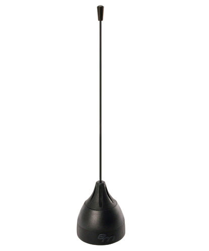

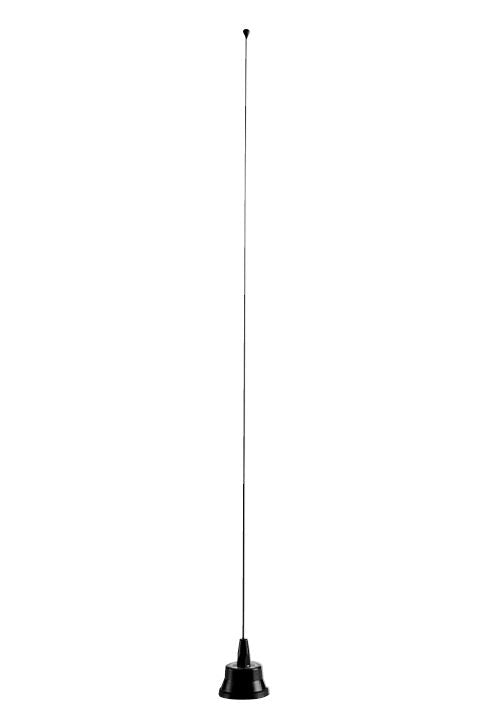

Instead of buying gaskets trying to make it work, just purchase one of the antenna types that does a proper job sealing. Won't cost much more and it'll be a better solution in the long run:

"Unity Gain" is 0dB, or the same as the 1/4 wave you have right now. If that antenna is working for you, then that's good enough. You could go with an antenna design that has some gain, but gain comes with tradeoffs. A 5/8th's wave UHF antenna will give you 3dB of gain, which may be helpful. However, it does that by compressing the radiation pattern down, which can have drawbacks in the mountains.
I'd still steer you towards the Larsen or EM Wave I linked to above. They have excellent sealing designs and will work with your NMO mount. I've never had any issues with either of those, and I've been running Larsen antennas for almost 35 years now, both on my personal vehicles and at work.
