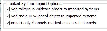

I am using the ez scan software. It imports all the p25 frequencies for that site. I hear nothing. Do the p25 have to be in a separate scan list from the analog frequencies?
They don't if you tell it to only import control channels, at import screen select IMPORT OPTIONS
Then make sure the bottom three options are checked.
