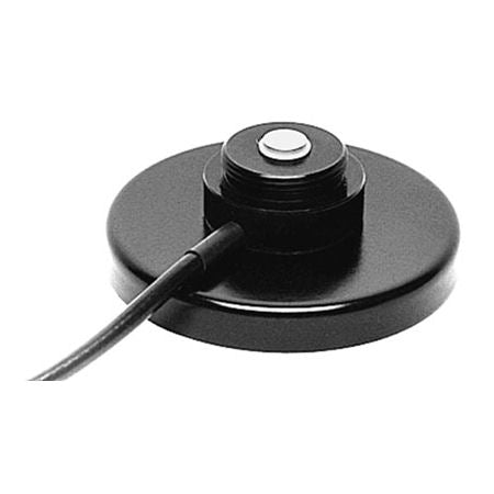

I was thinking a magnetic mount.
I'm currently running two other devices (12 volt), maybe an additional fuse block going to the battery as you said would be a good idea.
27,071
32,248
My recommendation would be to get a good mount, like a PCTel magnetic mount:
That'll get you a good starting place (for a mag mount). Avoid the cheap Chinese/hobby grade brands. A good foundation is where you want to start.
Then add a basic 1/4 wave VHF antenna. That'll perform as a 3/4 wave antenna on 70cm. Not a perfect solution, but it'll get you on the air and within your budget.
When your budget allows, upgrade to something like a Larsen NMO 2/70 or other good name brand antenna.
Your budget is kind of light for a good antenna setup, so start slow and work your way up as budget allows. You can save money by buing the cheaper products, but long term they are not going to last and you'll want something better. Remember, this is a long term hobby and you don't need to have a perfect everything on day 1. As you gain experience, your needs will change.
