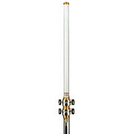

Looks like your 70 cm band is 430 MHz to 450 MHz. Here is a Laird TE Connectivity Model #FG4305 that has 5dB gain, omnidirectional, and covers 430 MHz to 440 MHz.
Is there a particular reason that you do not want VHF capability. Is it the antenna height that you are concerned about with a VHF/UHF base station antenna?

I was not looking for something compact but i thought a dedicated antenna for that band would give me better performance. At the moment i did what @popnokick suggested. It works fine but i lose functionality on both radios. I also looked at the antenna suggested by @K4EET, it seems a bit expensive for what it is. I thing that finally i will get another GP-3.
While the Comet GP-3 dual band base antenna's specs show 4.5 dBi gain on 146 MHz and 7.2 dBi gain on 445 MHz, the quality of construction may not be as good as the single band Laird TE Connectivity Model #FG4305 antenna. That could account for the cost difference. Most of the time, you do get what you pay for... ;)
I agree that the Laird is probably a lot better in terms of construction. My GP-3 has been installed a few months after the COVID crisis began. So far it as worked well for me but in my area the weather conditions are not that severe especially as far as wind is concerned. I have no clue on how much longer the Laird would last compared to the GP-3.
