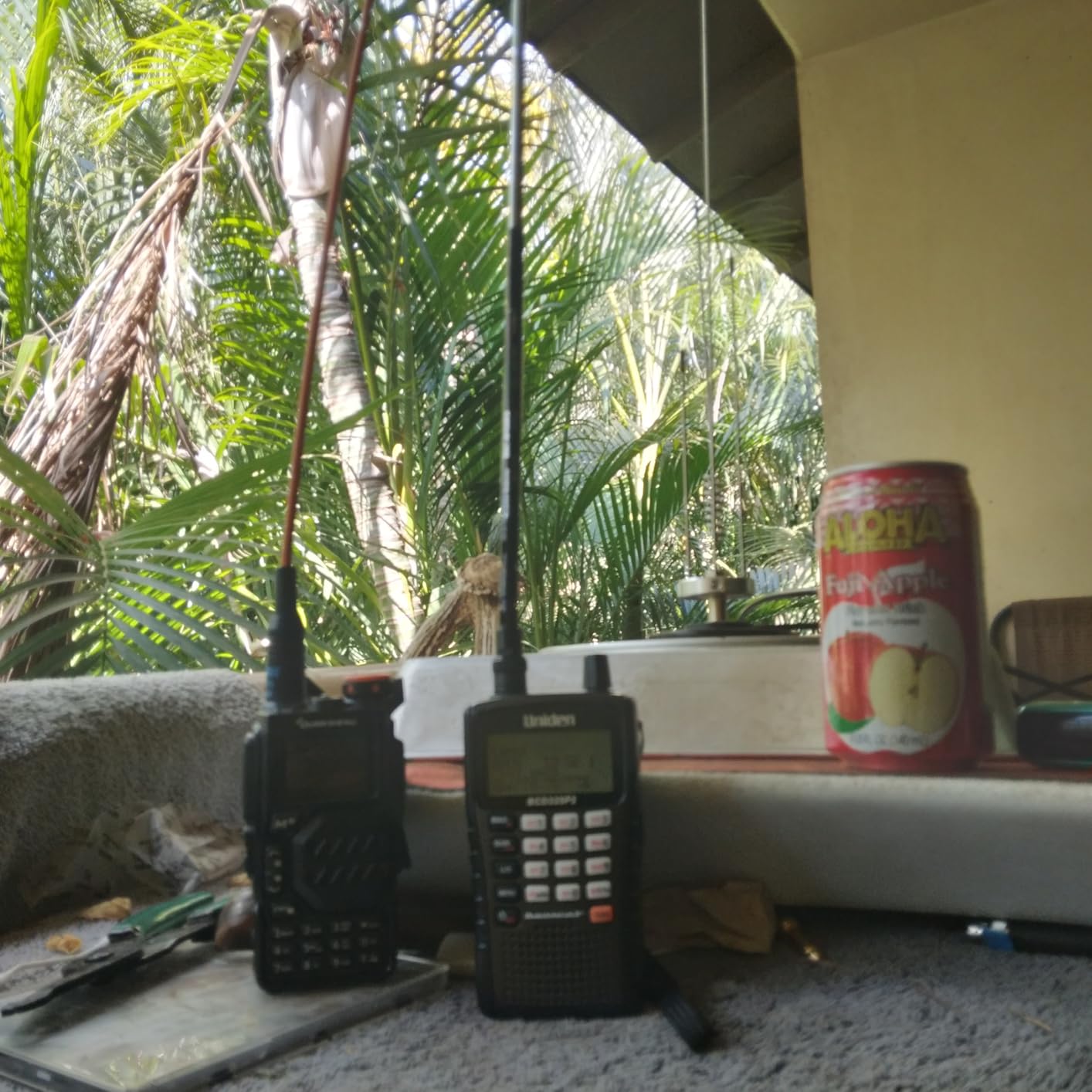

I don't own a 325p2 but the stock antenna is usually the first thing I toss in the junk drawer and forget about until years later if I have the ambition to do some spring cleaning. What antenna I use depends on what band I'm scanning at the moment. I've owned probably 10 of these Remtronix antennas over the years, always had good luck with 700 & 800mhz where simulcast distortion isn't a factor. For the lower bands, consider the Comet W100RX. An Amazon reviewer who gave the latter antenna a 5 star review was nice enough to post a pic of what it looks like on a 325p2
