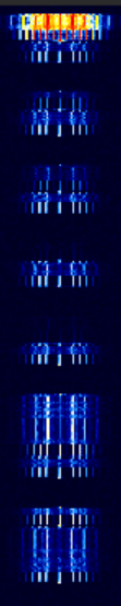

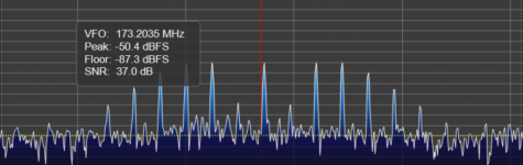

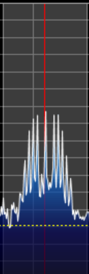

Picking up a strong data transmission from my area (Gibson Indiana) at 173.3005 MHz. It is constant short bursts of a screeching sound (kind of like dialup), punctuated with a short burst of static. Need help finding what it is. It may be POCSAG but I am not sure. I have attached 2 pictures of the waterfall and 2 pictures of the spectrum analyzer, as well as a link to an audio clip.

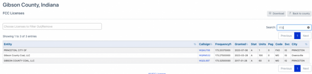

however also check IL since your county is right at the border
Callsign: KSA209Licensee: BARTHOLOMEW COUNTY R E M CRadio Service: Industrial/Business Pool, Conventional (IG)City: COLUMBUS, INStatus: ActiveGrant Date: 01/05/2023Expiration: 12/07/2032
Site: 2Address: 801 2ND STCity: COLUMBUS, INCounty: BARTHOLOMEWCoordinates: 39 12' 2.2" N, 85 54' 50.0" W
Frequency: 173.30000000
Site: 3Area of Operation: KMRA around a Fixed LocationCity: COLUMBUS, INCounty: BARTHOLOMEWCoordinates: 39 12' 2.2" N, 85 54' 50.0" W
Site: 4Name: HARRISON TOWERAddress: NE OF INTERSECTION OF S 475 W & W 250 SCity: COLUMBUS, INCounty: BARTHOLOMEWCoordinates: 39 9' 49.5" N, 85 59' 51.6" W
Callsign: WQWM411Licensee: BICKNELL, CITY OFRadio Service: Industrial/Business Pool, Conventional (IG)City: BICKNELL, INStatus: ActiveGrant Date: 10/02/2015Expiration: 10/02/2025
Site: 1Address: 203 WASHINGTON STCity: BICKNELL, INCounty: KNOXCoordinates: 38 46' 25.2" N, 87 18' 45.1" W
Site: 2Area of Operation: KMRA around a Fixed LocationCity: BICKNELL, INCounty: KNOXCoordinates: 38 46' 25.2" N, 87 18' 45.1" W

Not paging. Likely metering on a water tank/tower near you.
