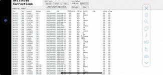

Attached an Image on the top one you can see the 0.0000 where it does this, This time it was the windy site.

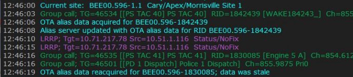

My thinking, based on what I see on sites around me, is it is possibly MDTs or other digital communications sending text notifications, like LRRP data. See the purple entries in the DSD+ FL event screen below...
