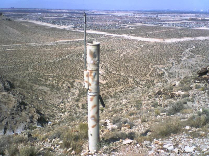

I was out exploring today, driving around the hills above Las Vegas when I saw a strange looking pole on the side of the hill on my way home. I hadn't noticed it on my way in becasue it was quite a ways down the hill, and the only thing visible was the whip of the antenna from the road. I stoped and got out of the truck to look at it and see what it was.
As You can see its some sort of Monopole. Its so wierd to see it out here, in the middle of nothing, on the side of a pretty steep hill. There is no way a truck or any sort of vehicle could have been much closer then about 20 feet to where it sits, and I didn't see any evidence of tracks in the dirt or plants.

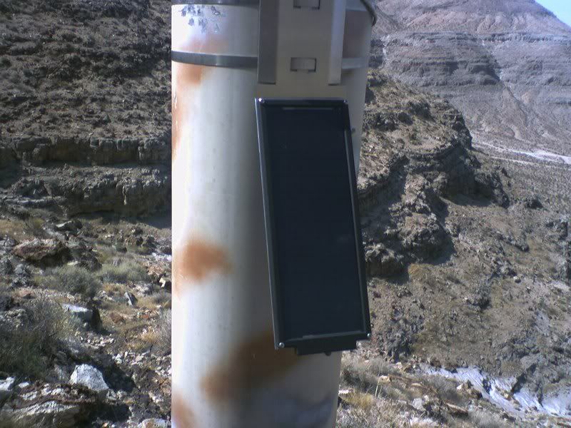

This Pole has What looks like a brand new solar panel on one side of it.
I knocked on the side of it, and the metal sounds very thin and lightweight. Also it has been painted in a camoflouge pattern-thats not rust.Its hard to see, but there are a few small caliber bullet holes in the bottom of the pole.

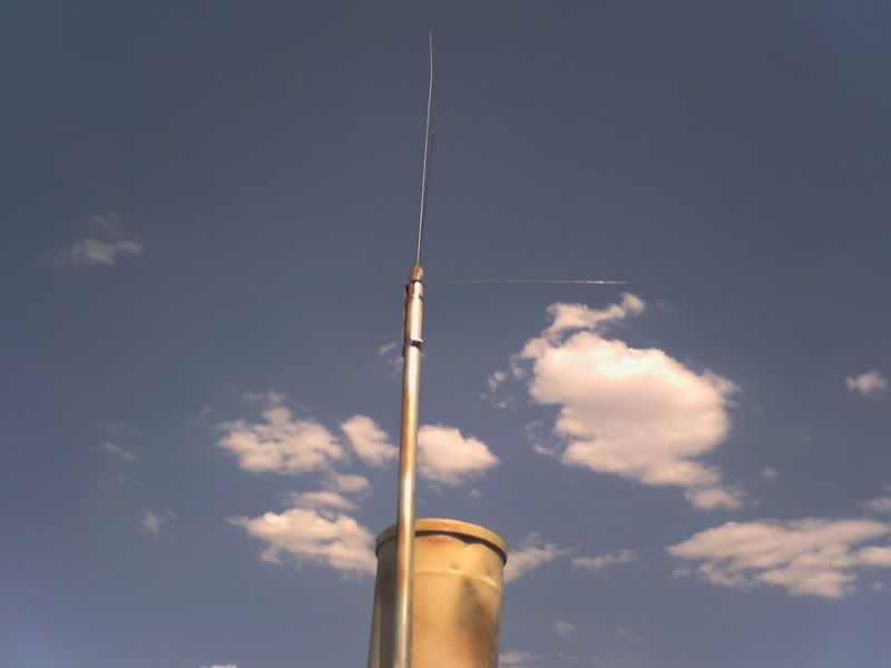

There is a bracket looking piece that has been welded onto the side and a short piece of mast has a mobile 1/4 wave whip antenna with 4 radials on it.

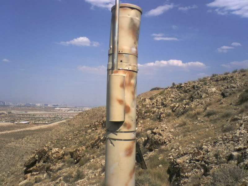

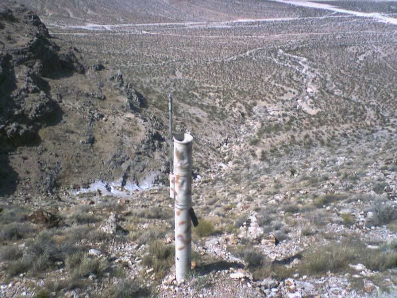

Very near Las Vegas. In the third and fourth pictures you can see the strip at the horizon about 15-20 miles east of where I was

They all have an antenna since they all transmit data to the central place for collection. You would almost have to have super vision to see the antenna in that picture though so your not blind. If you look at the rock formation on bj's solar panel pic and the formation in the 4334 pic I posted they look rather close.

Theres no directioal antenna, because you can see there is good line of sight to the whole valley. I could bring up all of the repeaters I tried with my HT on low power-500mW.

I believe that they would shoot them up too. This one is really very well camoflauged. It is set below sight from the trail. From the trail all I could see was the whip of the antenna, and only because I fixed in my mind where I saw the pipe thing. The paint they used was the exact color of the dirt all around it, and the rust made it blend in with all the plants. The outline was the only thing that caught my eye. This was the third time I was up there, and the first I had seen it.
