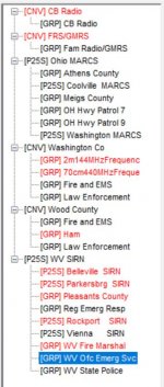

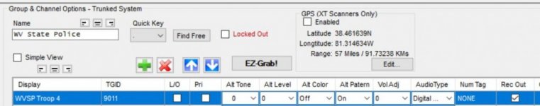

Not sure if you're still having trouble or not, but this is my setup for the Vienna tower. I echo what WV8VFD said, you need TG 9011 and really just focus on the Vienna tower. I am in Lubeck and do have the Belleville and Rockport towers programmed but they are skipped so that my scanner isn't searching them for traffic that will likely be on the Vienna tower anyway. I've heard TG 7101 on the Belleville on the past but not enough to keep it active. TG 7927 is also an interesting channel. Using the setup below, I don't have any issues hearing Troop 4. When you have it programmed, are you seeing a signal level on your scanner?
Also, it looks like you have a lot of sites active in your file. I only have the sites that are within distance added to my radio. In SIRN on RR, you can click on the tower location and it'll show you a coverage area. If you're outside that area, there is no need to even load the site. I absolutely think this is a case of your radio scanning so much stuff that you don't hear anything.
