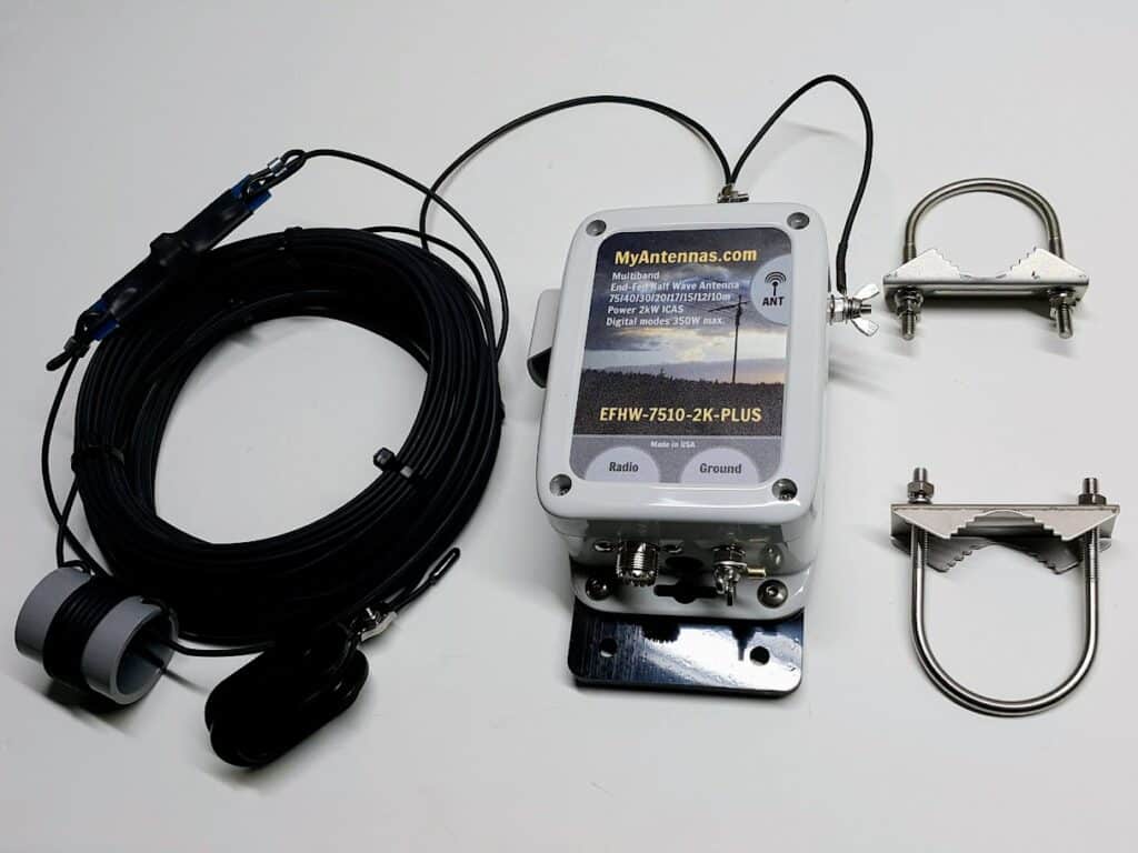

I live in an Hoa. Luckily, the builders used radiant OSB for the roof sheathing. I have 250 sq feet of radiant OSB in a dipole arrangement pointed at 40 degrees Northeast. In the morning, I can pick up, WWV and WWVH fairly welll. s9 on the Airspy HF + AT 10 mhz. NY aero is coming in pretty good through out the day on 8-13 mhz. I also have a 150 foot efhw at 10 feet high. I get a higher noise but also a higher signal noise. Same situation on WWV and WWVH.
