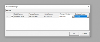

When I launch CPS (16 build 823.... do I NEED 828???), and try to recover I get this screen and I have no options other that the firmware and codeplug I have selected in the screenshot:
So great! But then I clock OK, and press "YES" on the warning to continue about the retuning... it thinks for a few seconds and I get this error:
Now crucially - right before this, I hear the windows "unplug a usb" sound that plays if you unplug the motorola programming cable. The USB connection is now no longer present in windows either.

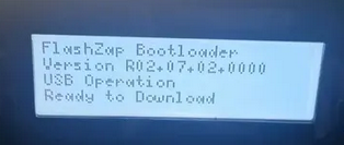

I suspect I know the answer to this, because when I do this in one of the xpr 6550s I see a similar message to this on the screen:
(SAMPLE - NOT ACTUAL SCREENSHOT)
And the behavior is identical (same CPS error code, same USB disconnect tone).

Update 1: I was able to install CPS 16 build 823 on an old laptop...for some reason the recover process was successful this time!
Side note: I previously had CPS 16 build 828 installed, but it was for the wrong reason. Not 100% sure how that happened. I uninstalled it and reinstalled 823...and the recovery worked for the 6350.
6550 recover seems to be running successfully now too..half way through!
One interesting difference - the "fresh" laptop has the MOTOTRBO Flashzap Driver installed.. my desktop does not!
