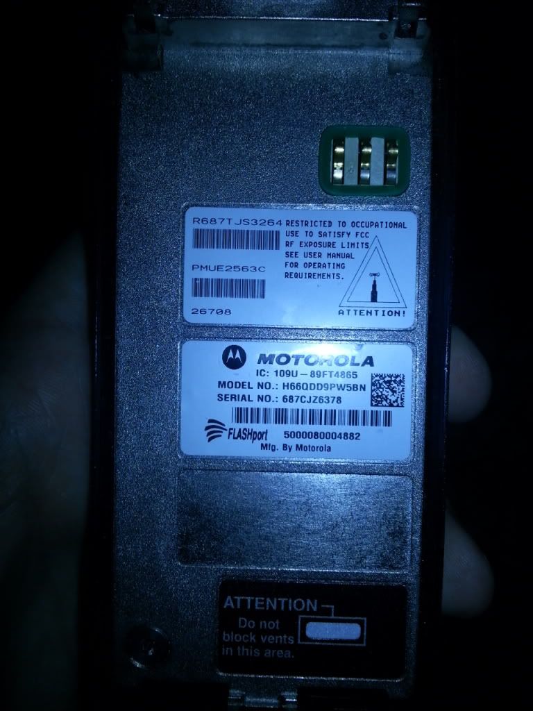

Here's a pic of one of the XTS units if that helps
I've tried on two different cps versions
R06.04.00 pictured and R16.01.00 not pictured

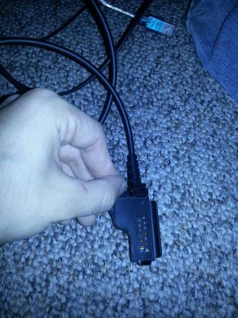

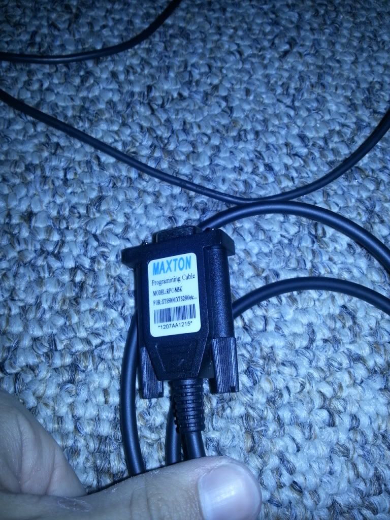

Here's the programming cable itself, says its for multiple models? I presume
This is probably the issue.
My adapter cable appears to be working fine after testing so will only
look into that more thoroughly if necessary.

Well, the picture of the CPS you posted won't work with your radio. In fact, it won't work for any ASTRO25 radio. You need ASTRO25 Portable CPS. Current version is R20.00.00.
I would just buy the proper USB cable rather than dicking around with a USB to serial converter.
SCPD
QRT
Feb 24, 2001
115
Virginia
First, the knock off cables or adapters hardly work and if they do and the drivers arent corrupt from the disc it came with which most the chinese knock off usb to serial drivers are, good luck if you don't brick a astro portable. By pic I can tell you that particular USB to serial will not work even if it says its working fine and good luck not bricking the radio reading or writing to it. Then you need the proper CPS mentioned above after applying for a MOL account, then signing ULA from Motorola and buying the CPS. You will need to provide the model and serial numbers when you order. This is for several reasons.
