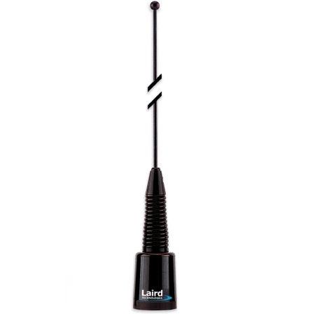

15 inches would be the length for the lowest designed frequency. At 450MHz, the whip would be 9 5/16th's. Add the length of the coil and the length of the spring, and you're probably pretty close to 15 inches.
The full uncut length is 12 3/4".
This is the one I ordered.
The bag it came in has the correct model # and the cut chart printed on it matches the one on the product page. So I guess they just run shorter than listed.
No, that sounds right. 15" is the full length of the assembled antenna:
Whip length + Spring + coil
The cut chart tells you how long JUST THE WHIP needs to be cut to be close to resonate at the desired frequency. You should cut it a 1/2 inch longer, then use your SWR meter to do the final trim/adjustment.
