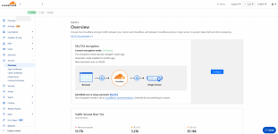

I'm trying to configure ProScan HTTPS using a Cloudflare Origin certificate and it is failing. I pinged Bob via email and he suggested that I open a thread here but followed up a bit later asking if there were any error messages. This is what I replied with and I'm hoping somebody has gotten this to work.
Hi Bob,
No rush on this. It has been on my back burner for a while. Yes, I am receiving an error on the HTTPS Web Server page of ProScan.
The goal here is to allow access to the ProScan server on my DMZ only from users that are forced through Cloudflare. This is achieved through various methods, but it boils down to restricted access to the ProScan server only though Cloudflare-supplied IPV4 subnets and secured through a Cloudflare Origin certificate/connection. I have this working on a few servers already but not with ProScan.
The requirement for this is running a Cloudflare Origin Certificate on the server using a Cloudflare-provided public and private key pair although I can supply my own CSR to Cloudflare if Proscan allowed for CSR generation. The Origin Certificate is a certificate that is supplied by Cloudflare that runs on the local web server and will only allow communication between Cloudflare and the server. Think if it as a client certificate. Cloudflare has a blog post on this feature from 2014: Introducing CloudFlare Origin CA
The challenge is that the ProScan server will accept the certificate but does not recognize the certificate as valid. Cloudflare will generate for me a public and private key pair which I’ve added to the server, but the result is that I receive a Valid “False” error message in ProScan. My gut tells me is has something to do with the domain checking that is done on the certificate, but without a deep knowledge of ProScan’s programing, I can only guess.

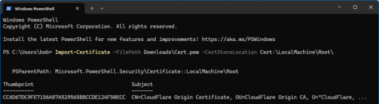

Does the Windows machine running your ProScan have the entire Cloudflare Origin root CA chain installed? anchored link to the CA root chain topic:
You might try installing that so the .NET API on the box can validate your Origin certificate directly. You'd install the PEM file into the LocalMachine\ROOT certificate store. You can do this from an elevated (Administrator) Powershell prompt after downloading the PEM file:
Code:
Import-Certificate -FilePath C:\temp\origin_ca_ecc_root.pem -CertStoreLocation Cert:\LocalMachine\Root\
Give that a shot, it's pretty quick to install the cert. If it doesn't work it's easy enough to remove it as well.

Code:
I tried that and it was still showing Verify=false

Found some time between meetings to work on this step. Camera off/mic mute meetings are the best. I'm up and running. Few AAR/items to reflect on:
  1. Running a custom version of ProScan software (24.0.2.0) the Cloudflare Origin certificate shows as valid and the web server starts. Thank you, @ProScan !
  2. I had completely overlooked adding the Cloudflare Origin CA certificates to the Windows trusted root store. I never missed this step on Linux... guess I need to go back to my comfort zone and get off of Windows. Cloudflare origin CA. Thank you @ndebaggis !
  3. Hitting the server locally and bypassing Cloudflare over the web (direct to origin) worked after these changes, but proxying a custom port through Cloudflare still failed even though Cloudflare documentation has a list of supported non-standard web ports that are supposed to work. I can confirm that some of these ports are not working through the proxy: Network ports Once I removed the custom port and went direct with 443, Proscan loaded over the web.
In summary, it was no single item above that prevented the server from loading through Cloudflare, but all of these items and each one was discovered once the thread was pulled more and more.
