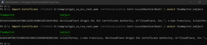

That look like your importing the actual issued cert into Trusted Roots which won't work since that's making the issued cert appear as a self-signed cert. Remove that from Trusted Roots then try importing both the ECC and RSA certs.
The two Origin root CA certs thumbprints should be:

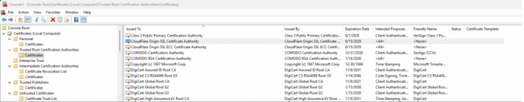

Not working for me. Still shows Verify=false. Does this screenshot look okay? and does the computer need rebooting?
Those two look correct. Take a peek at the Personal\Certificates directory as well as the Intermediate Certification Authorities\Certificates directory to ensure that original cert with "CN=Cloudflare Origin Certificate" didn't end up landing in one of those stores, if it did delete it. Also you might need to re-check those stores in certmgr.msc running just under your user context (not Administrator) as it could have landed there as well. All said, with just those two CA roots in local machine Trusted Roots the "CN=Cloudflare Origin Certificate" *should* verify in Proscan. If not, I'm at a loss to explain this one. Windows certificate management abyss of misery! - edit: maybe also a reboot will flush it out.
