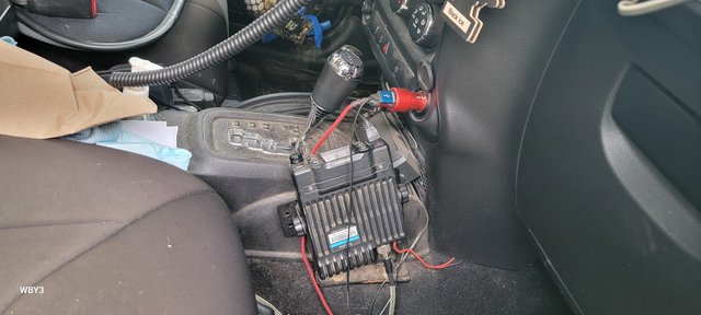

I have a Stryker 94hpc in my 2013 Jeep, small has a little more punch than a normal 11 meter radio. It does have FM but no SSB. Quadratec makes a mount for a CB for the Jeep I used. As others have mentioned, getting your antenna working correctly is the hard part. I have mine mounted on the tire carrier but the door is not grounded so I had to run a grounding strap from the door to the frame.

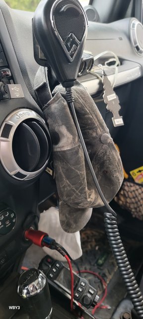

Nice pics of that Jeep install.
The SR65 mic is a nice upgrade.

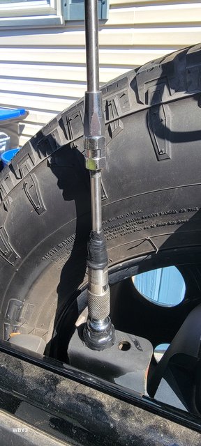

Got that QD (antenna quick disconnect) upside down.
I’d obtain a 5” riser (Wilson) or longer to get coil farther above roof atop an antenna stud. Re-test.
Rust/corrosion seen is a problem. Both sides of mount need to be shiny metal. Lightest layer of No-Alox or similar before install.
The Hustler QD is stainless, but the spring inside of it (?). One can’t get to it (Test with/without; maybe replace).
I’d wrap that set of junctions at antenna base with (1) of Rescue Tape and cover with (2) of Scotch 88. (Zip-tie ends down). Same at coax.
Woven braid RF Bond looks good. Needs bare metal underneath both ends.

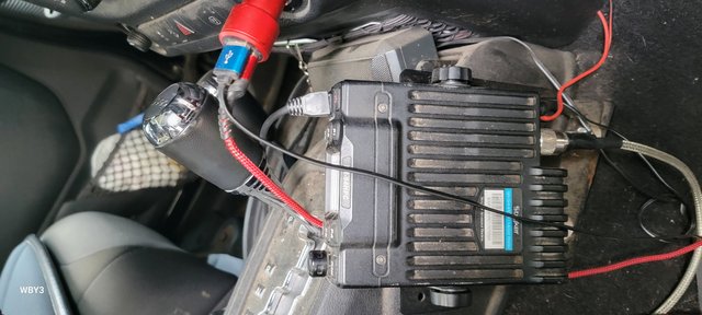

Cord/Cable management needed. As a truck driver I’ve learned the hard way.
Power is 5A draw @ 10’ so 12 or 14-AWG from BATT, and NEG to closest ground, right? (Fuse POS only).
With radio, the video points out good stuff:
Run an RF Bond from radio back or case screw to same location as NEG.
Can make from old coax shield.
Strongly recommend an extension speaker. Here’s how I mount a KENWOOD KES-5 to fire forward into drivers footwell in my pickup (can also maybe go completely under seat).
You’ll pick up (hear) more than before. Big change. It’s high efficiency. I can listen to NOAA from 40-yards with the Cummins idling away, door open and radio volume nowhere near all the way up.
Find used on eBay, or new. (Paid $12). Mil-spec wet resistance. It’s what’s used in fire, police, EMT, etc.
Thanks for all the info. I've had this set up for a bunch of years now. I have a question, how is the Hustler QD upside down, that's the only way it could go. I need it for garages where I get my cancer treatments.

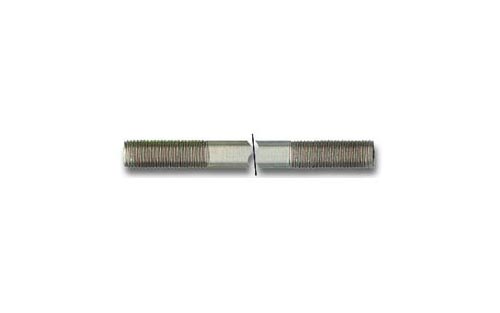

Orientation. Need a stud as shown in post. The secondary fits atop stud, the primary (big piece) goes to antenna.
Push down and rotate to remove.
You’re missing the antenna stud it appears.

I'm not sure I understand and I've had it the way it is for years. I pick up skip really well and get clear radio checks local, but there's not a lot of activity where I am anymore. I guess I'll, take it apart when I get a decent day to do it, but I'm pretty sure I'm not missing anything. As it is now I push the antenna down and twist and lift, the antenna comes out and the entire Huster gizmo stays where it is. Are you saying the Hustler gizmo should come off too, attached to the antenna shaft?
Ok I found a couple photos that show it the opposite of mine, I will have to see if I can flip it somehow. Thanks for the heads up for sure.
Now that I think about it, I always wondered why they had the gripy part because I had to twist the antenna, not it, to disconnect. Oh well.

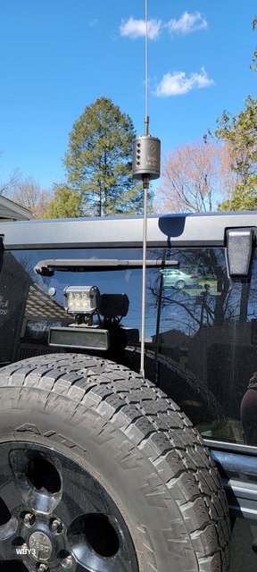

I got around to following slowmover's advice and changed things around, still have to find an open spot to tune the antenna better.
excellent! one of the few jeep installs that might actually work.... just amazing how people throw antenna's on a jeep with no grounding .... bad antenna placement and expect it to work.... hope it works great for you.... looking good so far!...... did you put wide RF bonding straps from the spare tire carrier to the tailgate and the tailgate to the body and frame???? I personally think it helped a great deal on my pick up install.
Yes, gate to body. Scroll back and see the before photos. I've had that set up for nearly the life of the Jeep, which is a 2013. It was pointed out the quick disconnect was upside down all that time, that's what the most recent photos are about.
