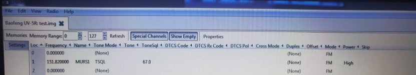

If I set the Tone Mode to TSQL and then try to set the Tone and Tone Sql, it removes one or the other.

Looks like you are using CTCSS tone 67.0. Use the same setting in each radio and you should be good to go.
I have radios A and B with those settings, and radio C without any special tone settings (acting as the outsider radio for testing), and A and B can still hear C.
This appears to be a Baofeng specific programming issue. I'll leave it to others that are familiar with these radios. Good luck!

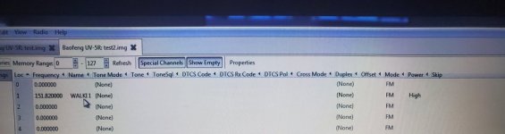

Make certain radio C isn't transmitting any tone (or set it to transmit some tone other than 67.0).
Than make certain radios A & B are set to enable tone receive (TSQL).
If set up properly, Radios A & B will be able to hear each other, but not hear Radio C. But Radio C will hear both Radios A and B because it does not have tone squelch enabled.
Here are Radio C's settings,
I appreciate your help. :)
