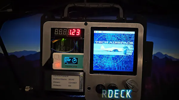

I haven't yet field-tested my "portable SDR", but I did realize the "cyberdeck" potential.
Of course, there are a couple of issues.
  1. I have little interest and limited resources for creating a (requisite?) "steampunk" enclosure for the LCD/PC/SDRs.
  2. A built-in 12V battery would be a challenge, especially since I wouldn't plug it in without a regulator (or "stabilizer" as kids call it nowadays).
Nevertheless, Cyberdecks are evidently a thing.
