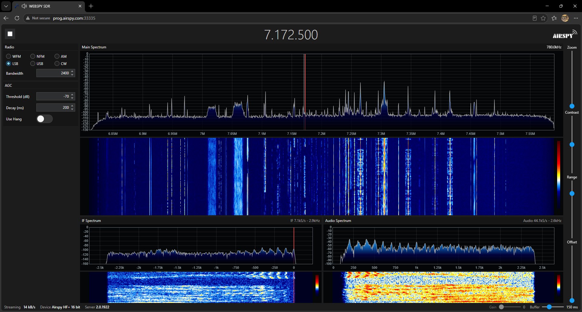

Airspy has just posted some demos of their web-browser based client.
This will make remote access from any OS possible.
