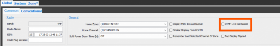

Good afternoon,
Im currently using a BKR5000 and when I hit the push to talk my screen shows A,B,C,D on the screen with the option to select one of those with the softkeys. I'm curious what this is and how do can I disable it?

The tick boxes you are looking for are "DTMF Live Dial", there are two locations where this can be enabled. The global is on the Common tab, the per channel is ... well per channel. I am always learning something new so if anyone is aware of another place this can be set or if I'm way off on the original request please chime in!

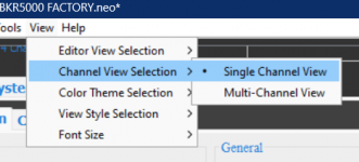

Change to Single Channel View
