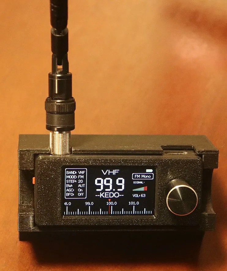

Looks great! Thought about doing the firmware upgrade? It makes the receiver so much smoother to use.
I thought about it, but with my luck I'd brick it. I've read a couple of messages where people bricked theirs, and I don't know if mine is the 8 or 16 megabyte version. Currently it works, even though I like the display on the upgraded model and don't like the timing of the button presses currently.
Do you know the link to the most current version of software... and maybe foolproof upgrade instructions?
