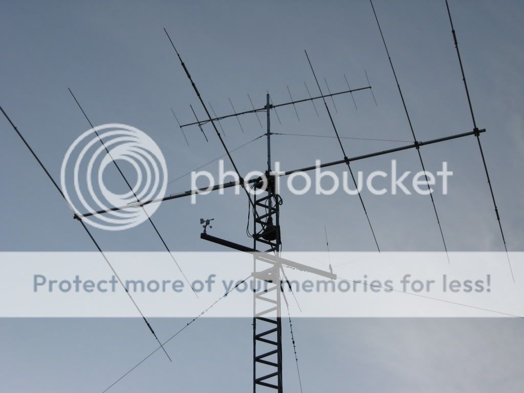

That does it for the vehicle, so here is the home station. My radios are not super impressive and I believe that antennas are FAR more important than rigs, so here is my main tower. 50 feet to the HF yagi. It is a 6 element tri bander. 24 foot boom, 32 foot rear element. Above that is an 11 element 2 meter beam for SSB work at 60 feet. I have since added a big dual band antenna above the beam for local FM work. Then you can see the cross arm with the weather station and a dual band GP for scanning.
With only 100 watts, I have been able to work over 200 new DX entities in less than 1 year.
