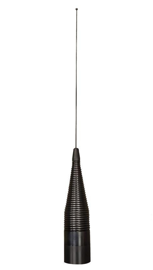

If you -just- want UHF and 700/800/900MHz, you can do one of these:
No idea how well they work, but they do look silly. Not sure you'd gain much by just having an antenna that specific. Not sure if it includes the "kick me" sign to go on your back, or if you have to supply your own.

Wow.. hahaha thats an interesting looking antenna.. surely em wave made that for a contract they didn't like! Thanks for digging that up mmckenna! What are your thoughts on just rolling with a monoband uhf antenna for tx/rx and 7-800 rx only?
