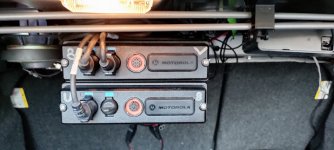

Hi :)
Can a APX2500 or APX4500 be dual bricked with a APX6500 AN or BN series providing they're all on the same firmware?
I have an APX2500 VHF just laying around with dual radio flash code installed and 4 x APX6500 radios (3 x UHF & 1 x VHF) with identical dual radio flash codes;
2500 VHF: BN2049-0116R0-7
6500 VHF: BN2049-0116R0-7
6500BN UHF: BN6049-0116R0-8
I'd like to dual brick my APX2500 with a APX6500 UHF if possible. 1 x E5 or 07 control head and cable run is far easier and neater than 2 control heads... And I cannot afford an APX 8500 or dual band APX7500 ;-)
Thankyou!
RadRom
Aug 29, 2021
15
Ballarat, Victoria
UPDATE:
I can confirm after some help from Radio Reference people, my APX2500 and APX6500BN are working very well together as a dual radio setup. :)
Both radios are on FW R26.04 connected to a 07, just waiting on my E5 to arrive.
Anyone else looking for similar info; APX2500 VHF and APX6500BN R1 are working very well together in a dual radio setup on the same firmware.
I hope this helps someone :cool:
