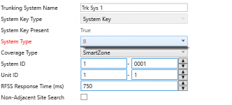

If my memory serves my correctly the lower-tier APX models (900, 1000, 2000, 4000) can do EITHER SmartZone OR P25, but not both simultaneously. Maybe try deleting any other system that's in there and trying again?
Mar 15, 2008
1,448
1,397
Its red because QA03768 is in the flash and makes it so analog type II will not work
