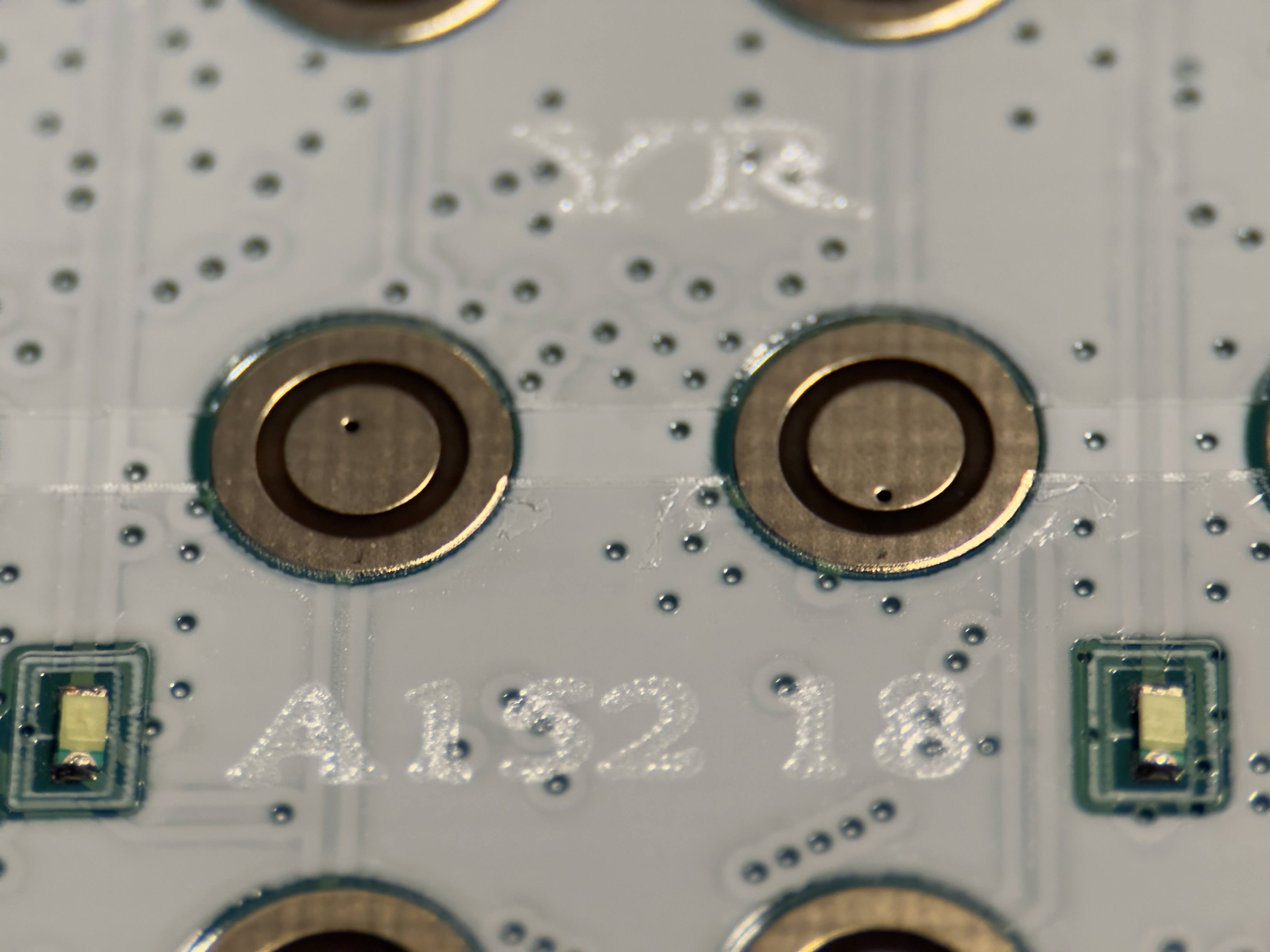

Because of this thread I decided to gather some information.
Here's what I have so far:
There is a tamper switch.
the opposite side local circuitry below
Note: the display was removed. the slit at the bottom of the image is one of four places the metal shield tabs were bent to hold and there is a ground at each of the four slits.
cast aluminum frame
to be continued.
Sorry, I lost connection there. Here's more.
Something to note: When I unbent the tabs from the metal screen frame and pulled the unit away, there were some markings on the screen that seemed to have a view characters I can't recall what letters. but there were a couple vertical lines as well. based on the design I assume that is from removing the screen element I somehow either static discharged or there was some residual charge or an induced charge when I pulled the metal shield away from the display.
this was below the backlight diffusion panel
aplchndragon
Mar 2, 2025
I made an effort to verify that the numbers on the chips could be easier to search.
I assume this is for protection of sensitive stuff. I will investigate the substance and removal methods soon.
View attachment 179254View attachment 179253
YL260 •Ak1E (the smaller unit)
A T 1846S AP34U333 (the black chip)
HTL7G06S011P EREE0099 2323-JY
AK9R

The chip under the blob is probably a semi-proprietary microcontroller that runs the radio
I thought about that too. I'll know more hopefully this weekend. spectroscopy sensor (other project) comes in soon.
Looks like HTL7G06S011P is an LDMOS power amplifier good for 11 watts up to 600 MHz:
Feature #10505: uv-5r setting tab not working in chirp - CHIRP I found this chip was also used in a bf uv-5r
This image is of the uv-5r
I haven't done a closer inspection of the circuits for the uv-5r yet
LM2904B is an op-amp. They might be using it as an audio amp
LM2904B
EC 14
A T 1846S
YL260
5807M TL153
can't find anything yet
  • RDA1846S.PDF
  • EC14.PDF
