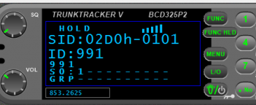

Try this to confirm you are receiving a Control Channel:
  1. Press HOLD
  2. Use the knob to scroll through the channels one by one
When you land on an active CC, you should see a SID pop up like this:
If you don't see a CC, you won't receive the system.
Good luck!

I am having similar challenge with adding "Charlotte UASI" to my Uniden BCD325P2.
I cleared the scanner of all systems, downloaded reference "Charlotte UASI" into ProScan v23.5. Without making any changes, other than shortening some of the names, I uploaded to scanner. The scanner scans displaying "Meck Simalcast" which haas the 30 trunking frequencies including the 4 control channels.
When I hold and scroll to any one of the four control channels (ref post #19), I don't see anything similar (i.e., "SID:???") Also, some YouTube videos show "P25" on the right of the top row of the scanner display. I don't get that but the System Type is set to "P25 Standard Trunk". I have no Quick keys set and no L/Os. It's like the scanner is not picking up the control channels.
Another thing. I see "P25 Channel ID Table" at RR and I have done nothing with that - don't know what to do with it if anything.

My assumption is that the control channels should sound like a truck idling (data transmitting). One of the four control channels (highlighted) sounds like a prop plane and the other three are static.
When I L/O the weaker 3 channels, I'm seeing more success, though not 100%. 1746445826408.png
I know using 1 control channel is a single point of failure but for testing, I think this is evidence supporting your simulcast distortion theory.
