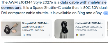

So the cable has this writing on it. Type CW E123760 SPACE SHUTTLE-C LL80671 USB REVISION 2.0

Uniden uses FTDI chipset on their cables I believe. Looks like the cable Bearcat Warehouse is selling is made by Space Shutlle-C or Z. Maybe someone who bought that cable from them can advise because I can not find any info on what chipset Space Shuttle cables use.

So I made a mistake on the cable E129760.
LL80671

The cable going into the scanner is E101344 style 20276 space shuttle-C
Call Bearcat Warehouse and find out where you can get the drivers for the cable.
If you are using Windows, you can go into device Mgr and have Windows search for the right drivers. I would try Bearcat Warehouse first though.

I would give the guy @ Bearcat Warehouse a call and asking him what chipset the cable uses. I searched those numbers and have not found one with the correct connector. Found HDMI and printer cables.
