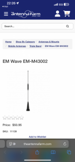

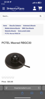

I’ve had this scanner for a few years. The audio usually sound like the person talking is swallowing the mic. Yet others understand them. Sometimes it’s crystal clear. It’s on all frequencies FD, PD, EMT…. Could this be a speaker issue? YouTube link attached of my 885 showing what I’m talking about. I’ve attached pictures of equipment used.

Here’s a picture of the same type of speaker I have. It’s mounted on the center console near the floorboard in the back seat. I had this same sound quality issue with the internal speaker. I bought the external speaker hoping it would eliminate the problem. The CB antenna is located on the roof passenger side rear on my ford explorer. The scanner antenna is located on the roof driver’s side rear. Both antennas are about 20”. I don’t think speaker location is the problem but it wouldn’t hurt to try a different location. I originally wanted it near my left ear mounted on the car frame until I realized I’d have to drill into the airbag.

CB antenna under 5’ not good choice.
NMO27 permanent mount a slight exception if one doesn’t leave metro. I’d rather see you (anyone) best prepped for rural as well (height is might when it comes to distance).
