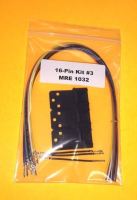

You can buy connector kits on e-Bay that will have everything you need, including wires with the pins already attached you just stick in the back of the existing connector that has your ignition sense pin in it.
