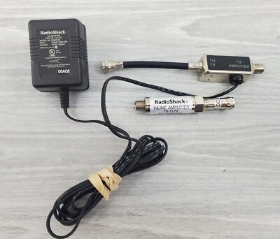

I was directed to this Radio Shack satellite TV in line amplifier that mounts at the antenna. I'm told I would need a PL-259 adapter and something and something. I'm told that the advantages are that I can run RG6Q cable which is good up through 900 MHz. The Radio Shack version has 10 dB of amplifier gain and a low noise figure. There's another model that has 20 dB gain but I think that's too high from what I've read?

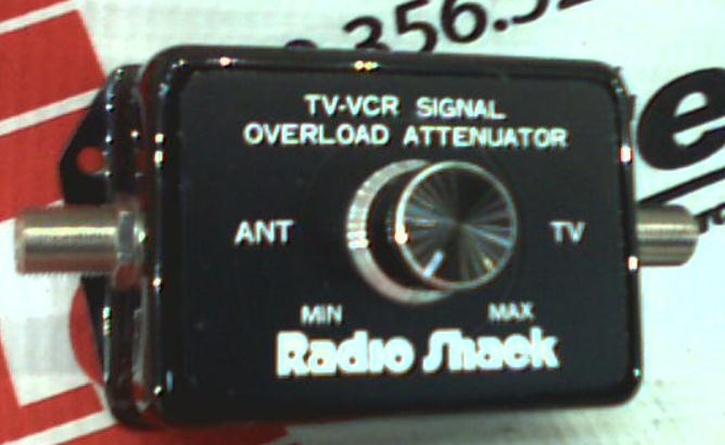

Lastly, one can either buy a handful of 3 and 6 dB inline attenuators or get a single variable attenuator. With the variable attenuator I'm told all that one needs to do is look at the signal indicator bars which should now be elevated when no signal is present. I'm told that's the noise figure showing itself. So then dial back the variable attenuator until no bars appear on the scanners. Or mix and match with the inline variable attenuators. The idea is to keep it simple. I can see the variable attenuator being most effective when using a 20 dB inline amplifier.

RG6 is good to at least 3GHz and there is no need to get quad shield. Any RG6 rated for satellite use (950-2150MHz) will be fine. Will the amplifier be used just for CHP reception or wide band through 800? If this is just for CHP reception the loss in RG6 at 40MHz is very minimal and probably doesn't warrant an amplifier.
Those types of amplifiers usually have high noise figures. Where can its noise parameters been seen and also its IP3 overload handling?
The correct method are to look at the digital bit error counter, if the scanner has that, and adjust for minimal value when receiving a digital signal. In other cases you listen with your ears to a weak signal in analog mode with not too much modulation, not a datasignal but someone talking, and adjust for minimum noise in the signal. In VHF band you should always hear the continuous NOAA transmissions. The amount of maximum signal that can be used are usually different depending of the frequency band. You can't use the signal bars when adjusting antenna amplifiers levels.

@prcguy It will be broadband. That amplifier as I recall from reading has a bottom end of 50 but I'm told it gives a bit of a bump down at 40 that overcomes line losses,f minimal as it may be. Yes, I'll be using it up in the 700 and 800. I was told that I should use nothing less than LMR 400 but it's not very flexible and the loss doesn't really seem to be that different. Based on the comments of @Ubbe I was able to look up the noise figure and found it to be 7.5 dB from 50-900 MHz. I guess using the attenuator would be used to dial out the noise figure leaving net zero gain.

That NF is kind of high. I think 2-4 dB is going to be in the right price/performance neighborhood. I only had a minute to look, but this RFLambda amp or this Stridsberg has more the kind of specs you're looking for, though not necessarily the right packaging, etc. Most of that won't matter much for lowband, but will be more important at VHF/UHF/800. Of course, if you're just listening to high-level repeaters that come booming in, it doesn't matter much, either.

Noise figure is determined by the amplifier and you can't dial it out. You can attenuate after the amp to reduce the overall gain but that does not affect high signal overload problems. You never want to attenuate before the amplifier. If the amplifier is placed at the antenna (where it should be) then cable loss is much less of a problem, get an amp that makes up for cable loss and maybe just a little more.

I was directed to this Radio Shack satellite TV in line amplifier that mounts at the antenna....
I have used these twice for their intended purpose, and both times they generated more noise than signal and went back to RS for a refund.
Absolute garbage.
Remember, the intention of a preamp is to overcome losses of the cable and not recover a signal that is barely there to begin with.

Most, if not all, scanners have bandpass filters as the first thing that the RF signal encounters and will have something like a minumum of a 3dB loss that will add to its noise level. If you amplify more than 3dB before the scanner it will overcome that filter loss making the scanner 3dB more sensitive. It would be like having two antennas stacked together. But the amplifier used needs to have a lower noise figure than the scanner to see any improvements, and also needs to be able to handle big signals without loosing sensitivity or overload and it doesn't use those bandpass filters as the scanner uses to filter away out of band signals.
Those amplifiers that use PGA103+ have less than 1dB noise and handle big signals pretty well. It's difficult to see that they can do a design mistake with those amplifiers, it's just a couple of additional components, but what differs are how they are powered. Some from the coax and others from the amplifiers power connector and some have both solutions and with different voltages. Just do a search for PGA103+ at Ebay or Amazon.
