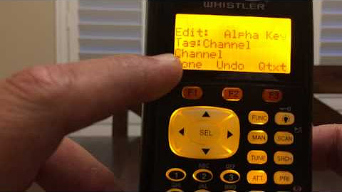

okay sir, i'm back. win500 installed. uploaded my first set of channels to a trunked lcra p25 TG. Scanner exhibits 'nothing enabled'. what am i missing. the walk thru on win500 .pdf fails to mention this bit.
Cfhebertjr
Nov 9, 2025
12
New Braunfels
the scan list 02 disappeared after an unexpected crash of the program. guess i needed to save it
Cfhebertjr
Nov 9, 2025
12
New Braunfels
apparently i did something right. i failed to add actual channels after adding talk groups. now receiving garbled transmissions from NBPD1763394670521.png
For a trunked system to work, you need both the frequencies used at the site, as well as talkgroups programmed for that system.
Looking at your initial screenshot in this post, you only have Scanlist 1 enabled. But in this later post, showing your talkgroups programmed, they are flagged for Scanlist 2. Be sure and enable the scanlist that you set for trunked system talkgroups, as well as conventional channels.
