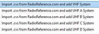

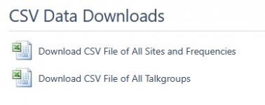

Importing from a CSV file isn't an option from what I see. If you read the option it is "import from a Radio Reference CSV" which needs to be downloaded from the database, but I believe only premium members are allowed to download files.
