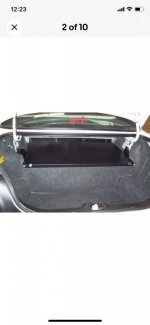

So I am looking to suspend a tray like these;
C-3190-F or
C-TTB-CVF (Heavy duty)
from the frame structure. Havis does not appear to have any detailed specifications as it is a "buy it, it fits your crown vic". But I am looking at the height of the mounting tray itself, the unusable space where the equipment bolts and will add to the overall height of the radio units I install between the tray and the frame structure. Also looking for depth of the mounting tray.
If anyone out there has detailed drawings of these products or can take a ruler and measure the moveable part of the mounting tray from the top surface where radios would mount, to the points below on the sliding bracket where it might touch the vehicle floor below. The Heavy Duty is probably beefier so having measurements of the standard would be appreciated as well.
