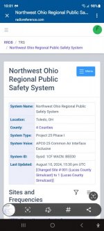

Just curious, what system(s) are you scanning and how many sites?
I have only these enabled. I turn off weather. I went in and avoided anthing I dont want it to waste time scanning as you suggested so hopefully I can hear more of what I want.

If you’re still having issues. Try putting it in your car and driving to one of the NWORPSS tower locations. That will eliminate any problems that may be caused by your apartment location.
You can click on the tower icons, that will show you the address of each tower.
