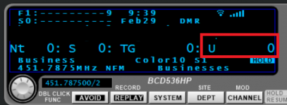

In order for UIDs to be displayed on x36HPs in conventional mode the channel name needs to be cleared. Do a channel hold on frequency in question. Press "E" then choose Edit Current Channel > Edit Name. Press "No" button twice to clear the name. Press "E" then press "E" again at "Set Default Name". Press Menu twice more to back out of menus and back into conventional scan. Unfortunately there's no way to do this in conventional mode with a channel name set. Uniden rectified this via the SDSx00s by adding UID as its own display line entry
UID will be displayed here:
This is the answer. A little quirky, but works.
