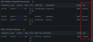

Have upgraded to DMR everything turned in Sentinel. Not hearing anything.. What do you listen to with DMR? I did a fresh install of only DMR freqs in Collier County, Hospitals. Am i doing something wrong? Can any of you advise what DMR you listen to in Lee or Collier County that you are receiving?
Thank you!

If said DMR is listed in the database you'll need to enable the applicable service types as shown in the "Tag" column in the RRDB. If you're listening to hospitals then the "Hospitals" service type will need to be turned on otherwise the scanner will omit traffic from those channels or talkgroups tagged as such

Thank you for your help. I have the service type checked . I am not sure what you refer to as the “ Tag" Column in Radio Reference DB?

I do have those services selected for Business and DMR. I checked those in edit profile. I must be missing something, I apologize for bothering you,
