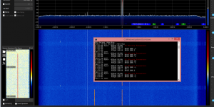

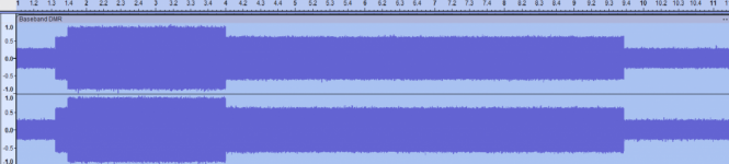

I play a DMR baseband file but dsd-fme doesn't decode anything, what should I do? This works fine with a normal wav file.

The picture shows that it's missing P25 Phase2 parameters. You need to add them to your command line, like:-X BEE00123456. Where the BEE00123 is your system and 456 is the NAC. It should decode okay then.
No no, it's not phase 2 of the P25, it's the DMR. I used dsd-fme -Z for auto-detection, with a normal wav file it works fine but with a baseband file it doesn't display anything or shows a tiny bit of incorrect P25 frame.

How is the audio routed? If you are to do something like this, you typically need some VC-cable to route audio from SDR# to DSD-FME. Also, since its SDR#, you'll need to hunt down and disable the multitude of audio processing like high pass, low pass, de-emph, and whatever else if you are using the community version with the 1000 mods on it.
