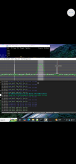

Okay I’ll have to do that when work gets quiet haha.
Do I have something wrong in the frequency file? I see a red error in the event

Yes, can you post what you have for L4-23 in your DSDPlus.frequencies file?
For L4-23 in DSDPlus.frequencies you should have:
TIIInonStd,4,23,311,854.8625,0,0
TIIInonStd,4,23,397,855.9375,0,0
I probably had a period where I should have had a comma before.
I had to put the L in before the 4
So when you start DSDPlus up now, you get no red lines?
And sorry about that -- in all the files reerencing that system, it should be L4 and not just 4. I know I gave instructions for just 4 and was wrong.
No errors now
Dsd freq populating with the channel numbers now in the event window

I downloaded those screenshots and enlarged them heh. Seem to be from the same frequency. Is that intended?
I had questioned whether you were sure that the other two frequencies that you listed (860 freqs) were part of L4-7.
i believe so. 860.8875 is a voice channel in the DB under utica cap+ system but seems to be being used with this "new" system
860.8625=368
860.8875= 794
860.8625=368
860.8875= 794
How did you determine 860.8625 = 368 and 860.8875 = 794 ? Do you have them in your DSDPlus.Frequencies file like that and they trunk track and produce voice? I only ask because if you ran across some sort of online calculator to calculate LCNs/LSNs, I doubt it's going to be correct for these sites.
No, Not in the freq file yet i was just watching the wave spectrum and the cc window box where the talk group was coming across. Maybe that the wrong way to determine them. I'm still a novice at this hahahah
