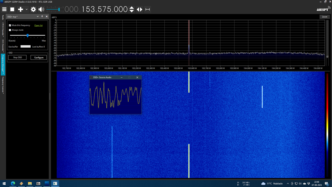

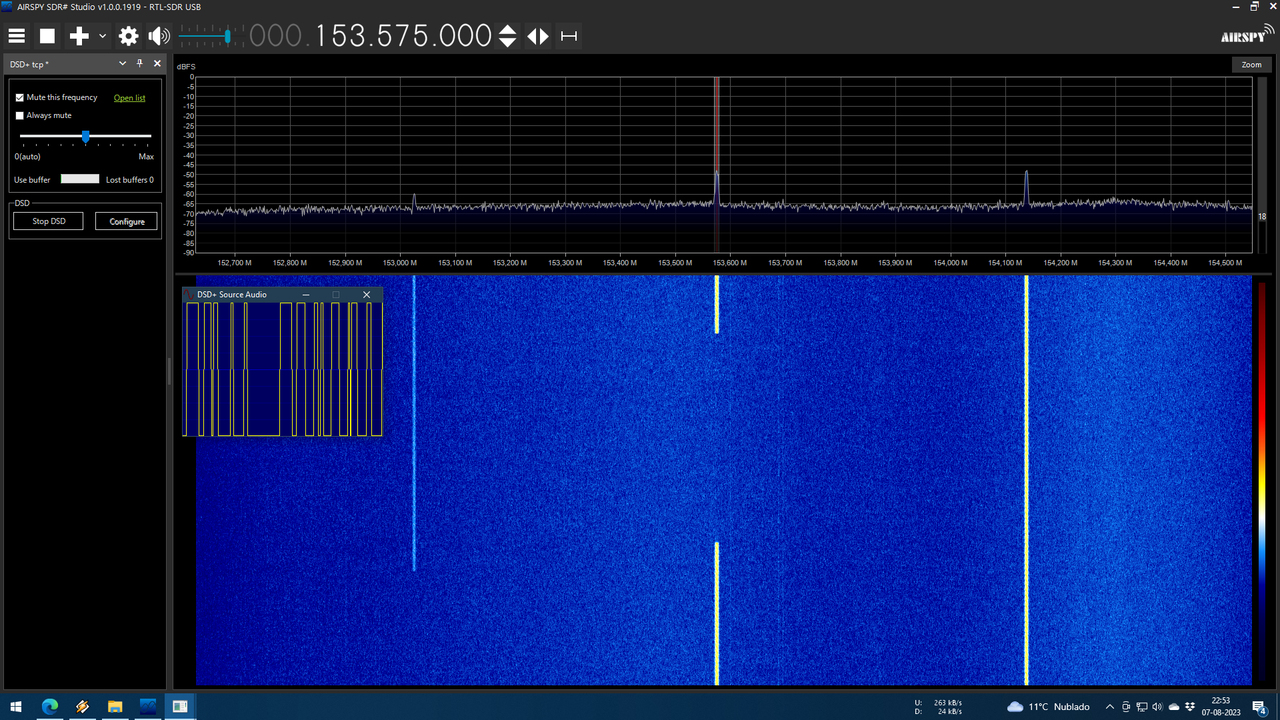

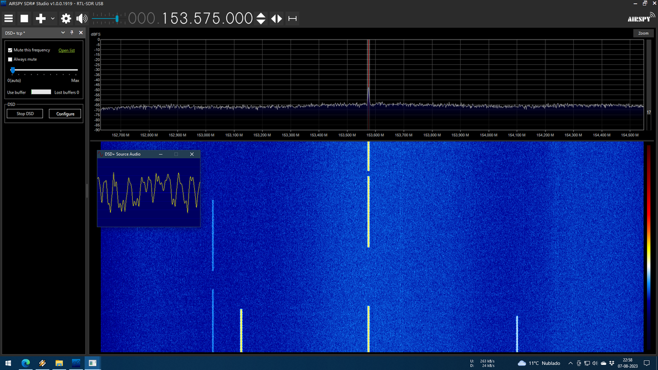

that in "0(auto)" mode it only works fine for the first frequency.
but it stop capturing audio if you change to another frequency fastly (for example when using a scanner).
also in previous versions of SDR#, for example in 1918 if you put that option in the middle, it captures DMR audio properly (according to the DSD+ Source Audio window)
but in 1919 it captures audio extremely saturated (according to the DSD+ Source Audio window) causing it to not decode anything.
unless you move that setting to the left, near to the 0.

Problem you see seems to be when the signal is squelched.
On investigation, it looks like the automatic gain value is running away and it cannot recover from it. Only adjusting the slider will reset it.
Another problem is the gain slider range. It's too much with newer versions of SDR# so it maxs out only after 1 or 2 positions.
New versions of SDR# are using a higher audio level than older versions.
