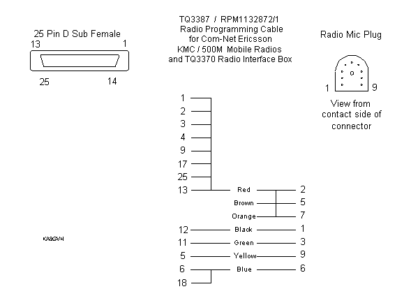

The 500M is put into program mode the same way as the Orion is - you power it up with the programming connector, well, connected. In the case of the 500M, that's screwed into the mic connector. You don't have to hold any keys, just power up with the connector plugged in.
The schematic of the cable is here:
http://www.hallelectronics.com/getech/tq3387.gif
Grounding 2,5 and 7 is (as I recall) what puts it into programming mode.
Hope that helps

Yes, timeout/radio not responding error, on read, write, etc. in all functions of ProGrammer and Radio Maintenance R18. This is with two different RIBless cables -- one does not connect 2, 5 and 7 to ground, only 7, and the radio powers up in normal mode but with TX keyed. If I jumper 2 and 5 it powers up in programming mode but the software can't "see" it. The other cable powers up in programming mode, but the same results from the software.
